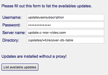

We received some requests to repair broken C-MOR Video Surveillance Database Tables that could not be repaired with the repair-db-table tool. Therefor we released another tool, recover-db-table.pml.
Please use the update function to install the tool on your C-MOR with following settings:
C-MOR Recover DB Table Tool Download.
Once the tool is installed it can be used with this URL:
http://<c-mor ip>/recover-db-table.pml
