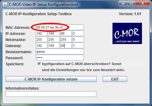

You need the IPconfig tool from the C-MOR Web/Download Page.

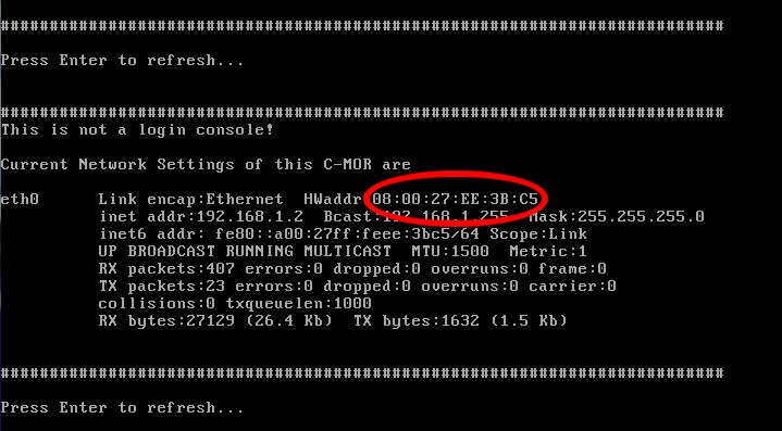

See here, i have marked the MAC Address where you find it on your VM and where you need to set it on your free C-MOR VM:
Here you find the MAC address...
IPconfig tool to set the IP address
screenshot ipconfig.jpg (77.1 KiB) Viewed 11946 times
