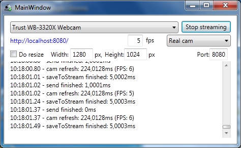

I want to pick up on the subject USB cams.
I got C-MOR running with a simple, inexpensive USB cam with the Windows program webcamserver10
Simple Webcam Server
You can download it here:
https://code.google.com/p/webcam-server ... loads/list
Is anybody interested in that? I may post a little documentation how I got it running!
