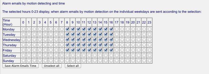

I applied the upgrade with the new alarm email table in the camera configuration. I don't know how to benefit from this update.

Hi,
Make you sure you have set up the email settings in the System Administration and for the camera you want to use for motiona alarm emails.
In the camera settings menu you will find the new time table. There are 3 tables after the update.
If you want to send C-MOR all the time motion alarm emails then keep all marks active for the 3rd table. If not, then un select all and/or select the times you want motion alarm emails.
Watch the example which has motion alarm emails activated at certain time only.

- Example for motion alarm emails during hours you are at work.
- Bildschirmfoto 2012-05-25 um 10.29.57.png (37.5 KiB) Viewed 8920 times
