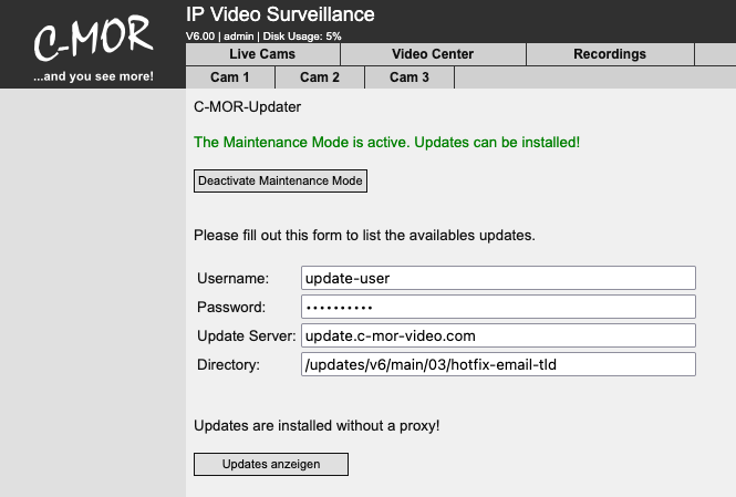

In the video surveillance C-MOR V6 up to version 6.00PL05, there is a restriction that a maximum of 4 characters are allowed for top-level domain information in the email address. Since many new top-level domains with endings such as .global or .travel cannot be used for system messages, a hotfix has been made available. The hotfix can be installed in C-MOR versions 6.00PL04/PL05 by manually entering the path shown.
When entering the path, it is important that the number of C-MOR licensed cameras remains unchanged. In the example, there are 3 cameras. When entering, only the last part needs to be changed from:
/updates/v6/main/03/C-MOR-V6-6.00
to
/updates/v6/main/03/hotfix-email-tld
(the 03 remains unchanged here).
