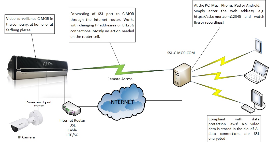

Since some Internet providers have started blocking publications on their Internet routers, services like DynDNS no longer work, and there is no way to access C-MOR from the Internet. This problem can be circumvented with C-MOR remote access, as this technology allows C-MOR to open a tunnel from the private network to the Internet and access C-MOR via an encrypted tunnel on the reverse path.
C-MOR remote access has now been enhanced to include a fixed web address with an SSL certificate stored on the remote access server. This eliminates certificate issues on the C-MOR itself.
The new address is https://ssl.c-mor.com:<port number>, with port numbers automatically assigned to each user.
